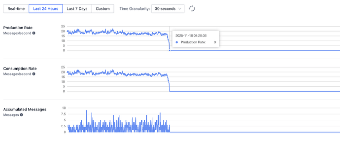

Current status:
  • Ticket opened at Tuya to urgently help with the issue
  • Authentication with Tuya and sending commands via Apilio seems to work fine. So the issue is “only” with the receiving of data from Tuya
  • We did not deploy a change affecting the interface for weeks, and also no configuration change on either side lately.
  • There is no apparent issue with our listener service - everything looks very normal
  • The Tuya app continues to work fine - which is not unexpected, as it seems to use another (internal) interface than 3rd party services are offered
Here’s a sad image where the sudden stop of messages is visible:
This is an unprecedented incident for us and I cannot give an estimate when it will be fixed. Can be any minute or days.
I suggest you try to find a “backup” mode where you can operate the basic function without Apilio logic.
