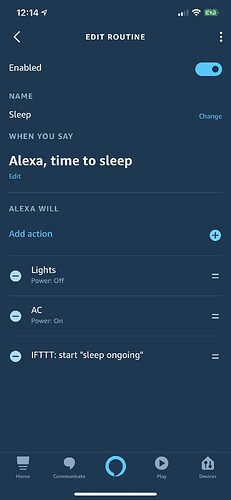

Creating the Alexa routine to turn on AC when sleeping and to update Apilio sleep state variable
[Important] What you put here in the “When you say” section is what will cause everything else to run.
[Note] My AC is connected to a Kasa smartplug which in turn is connected to my Alexa.

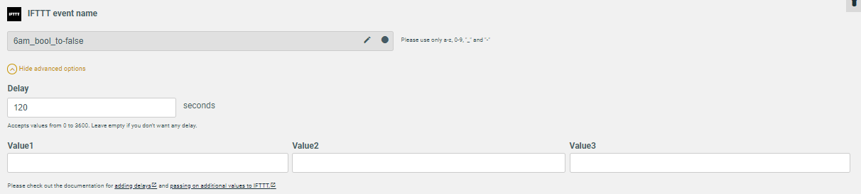

[Important] I wait 2 minutes before resetting to account for any processes that might update slow
When the time variable gets updated to true, it will reset back to false after 2 minutes
Annotation 2020-06-10 124540

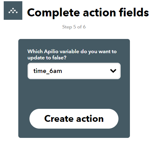

We must create the IFTTT action to update Apilio time variable to false
This is from the Apilio logicblock
Heres the logic, remember that this will happen 2 minutes after IFTTT update time variable at 6am

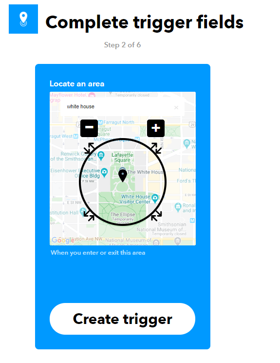

Need a way for Apilio to tell if we’re currently home so that it only turns the AC if someone is present.
First we need Apilio location variable which IFTTT can update
IFTTT location trigger
— Being home is a boolean so it’s easier to chose the toggle option here
Enter your home location
Have Apilio update location variable
Heres the logic

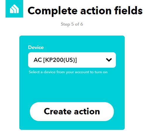

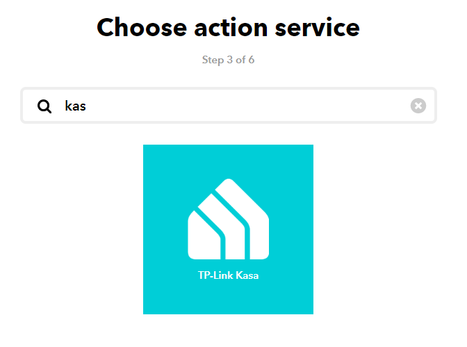

Now we can finally set up our final logicblock that will check if we are home and if it’s 6am. If both are true, IFTTT will tell Kasa to turn the AC on
Annotation 2020-06-10 130405
Last IFTTT trigger (previous picture)
kasa will turn the AC on if home + 6am
Final logic
