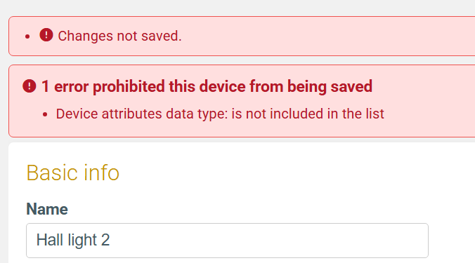

I’m trying to read some of the device attributes such as “switch LED” to determine if a bulb is on/off or “fault status” for a dehumidifier to indicate that the tank is full.
What I’m seeing is that some bulbs will have these attribute variables (such as {{bv-53735}}) available whereas another identical make and model of bulb that I have setup does not.
If I try to enable any attribute on these I get an Apilio error (see attached).
Another example is with two identical Tuya-enabled dehumidifiers. One is showing all of its device attributes whereas the other is not. And when I try to add the attribute that’s not showing I get an Apilio error.

Hello @joe.ferris,
this sounds as if there is a bug in the synchronisation.
Can you contact us via chat to name one of the devices so we can have a look?

We had to make an update to make this work, because the attribute used an uncommon data type thatt was not yet supported by Apilio.
