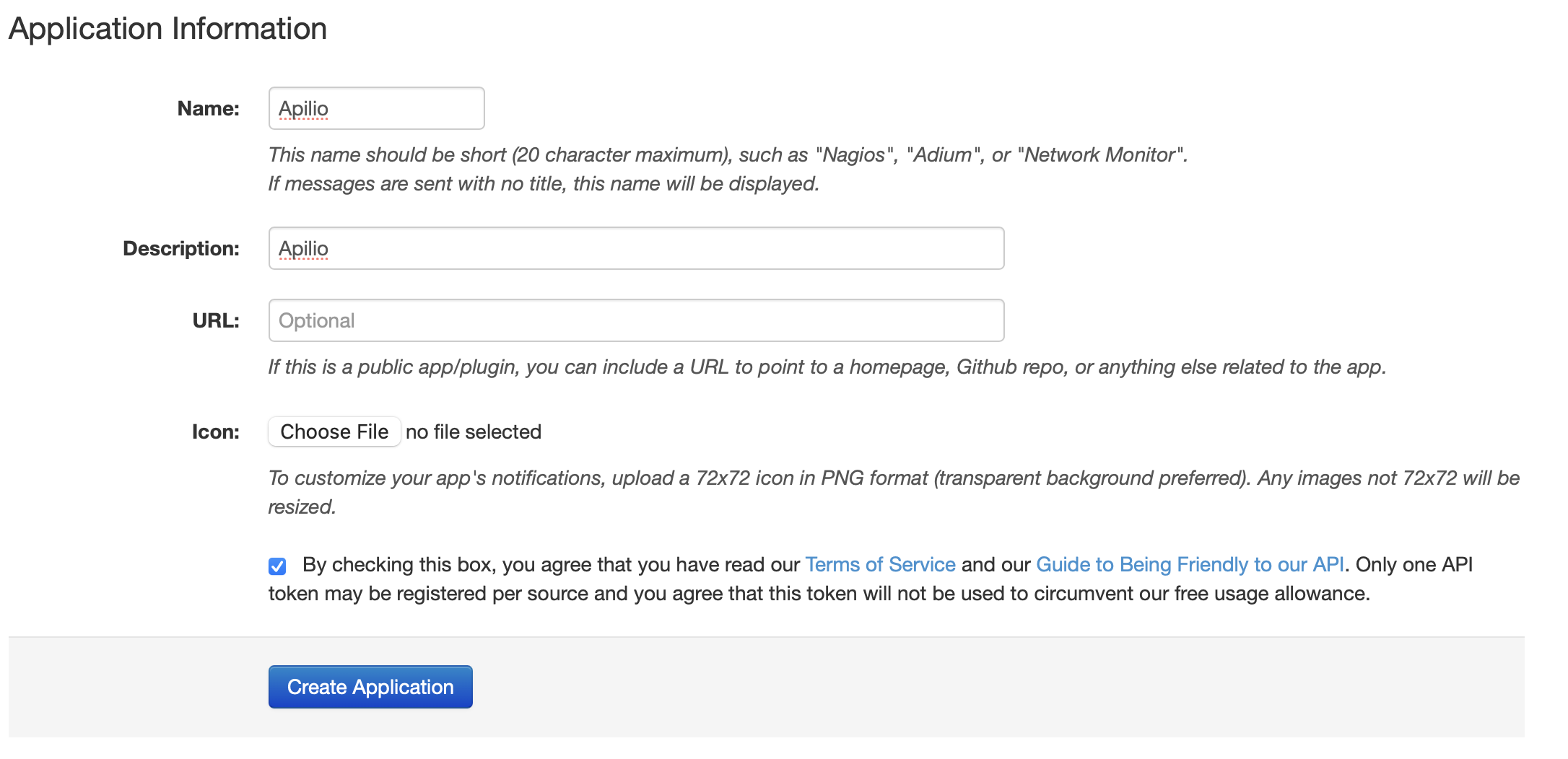

Create an app
After logging in with you personal account, you need to create an “app” with a name and description you choose. e.g. like this:

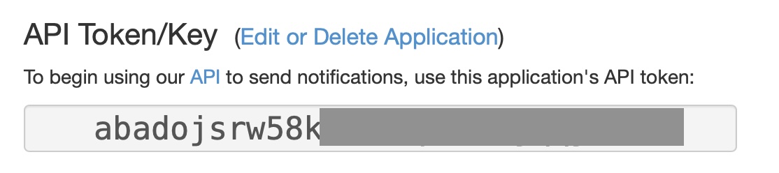

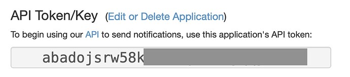

Copy the application API token
From the overview page, scroll down to the bottom to see the apps. Click the app you created to see the details. It displays the API token at the top, which you will need later as well to set up the notification.

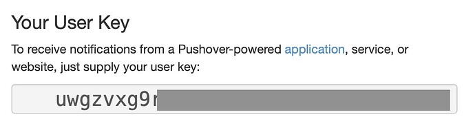

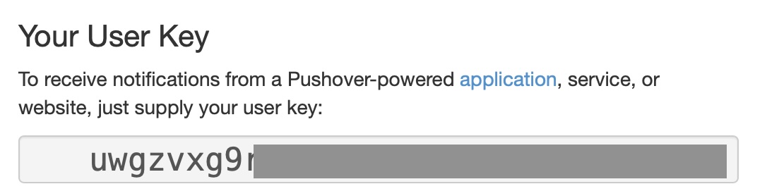

Copy the user token
At the top of the overview page, you can find the user token, which you will need later in Apilio.
