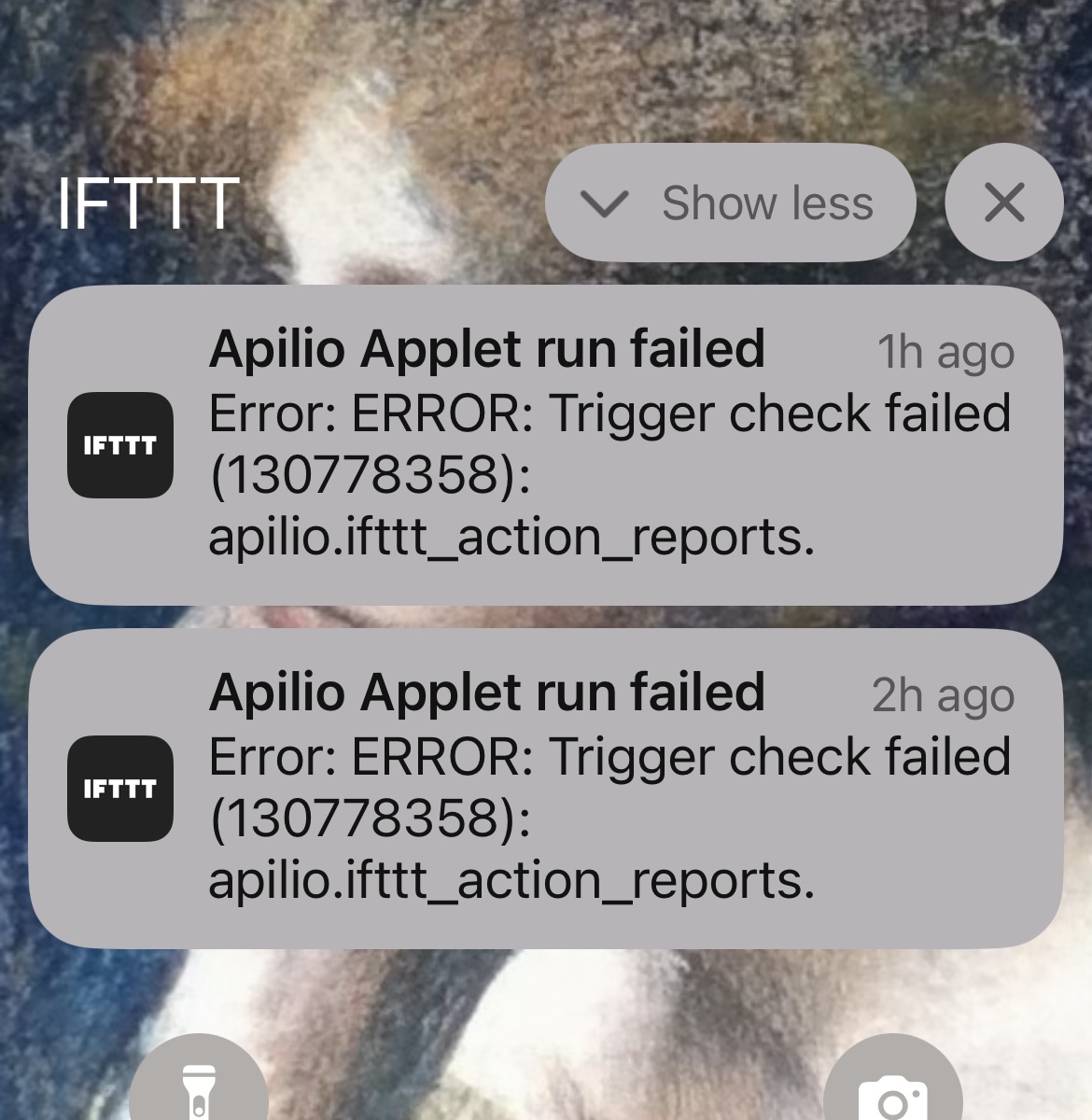

These two notifications just arrived. Maybe they shed some light?

Hi @Antyronnen ,
thanks for your report.
It seems that Apilio is responding to slow to IFTTT, leading to timeouts and the error you see.
I did temporarily increase the resources to see if this reduces the amount of errors. Please update here if you run into more issues in the coming days.
Hi pebneter, thanks for the update. Tonight one apilio ‘call’ to IFTTT went through OK at 16.21 and another two minutes later threw up the same error message. I’ll monitor and let you know what happens.
