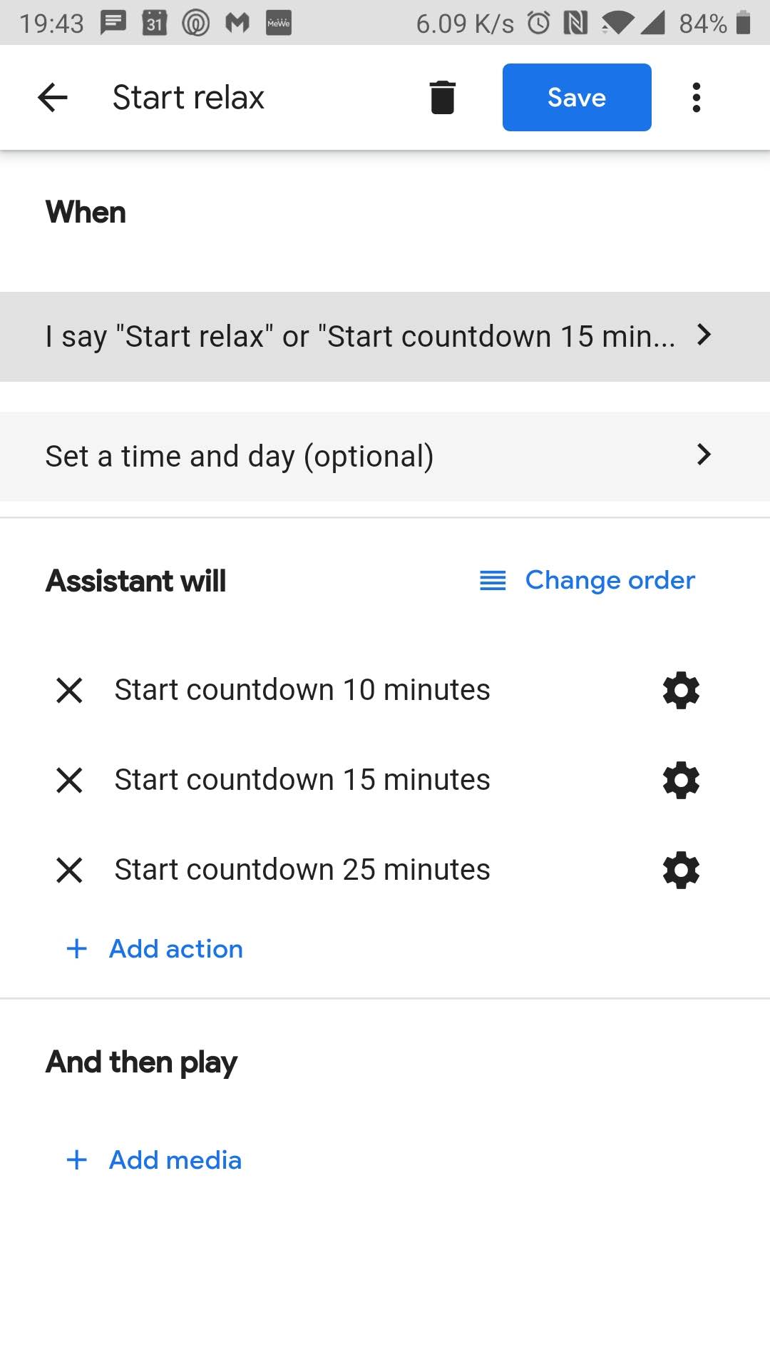

Sorry, I am being daft. Easy solution so long as i understand what you are trying to achieve
Create a new routine called “relax” So all you have to say is ok google relax
Within in the routine have 3 actions
you will have to type in the commands
Start countdown timer 10 minutes
Start countdown timer 15 minutes
Start countdown timer 25 minutes
Save it
when you say ok google start relax it will read out the 3 timers it is starting
you can check the how much time is left by saying. OK google check countdown
I’ve tested it and works on my google home. Note i set it up on android phone

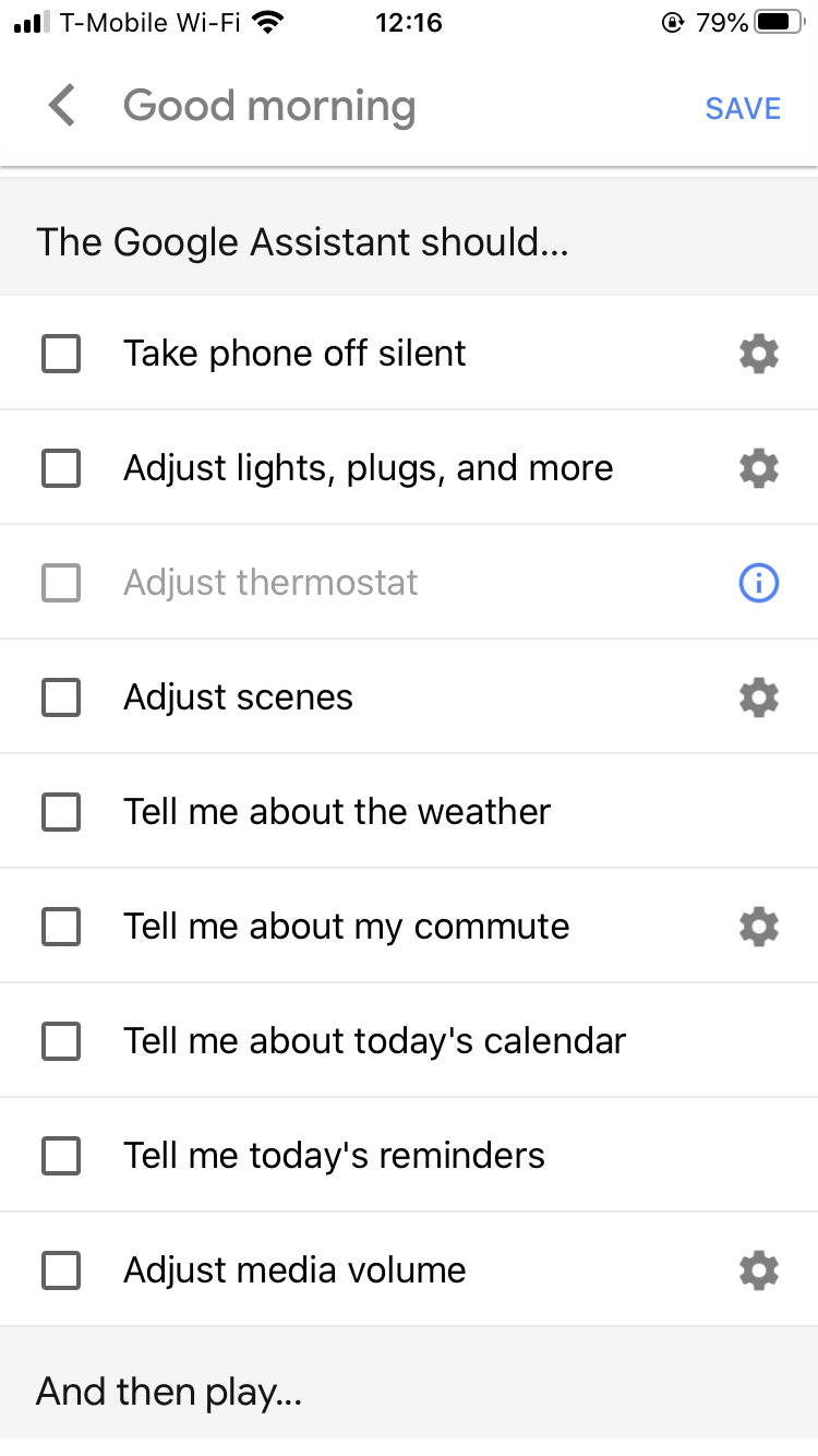

Hey there - thank you so much for another response! I thought I was going crazy because I had already tried Routines on my own, then again after your first response, then again just now - the create custom routine and the add custom action buttons just weren’t there…
And, for whatever reason, I never looked up “can’t create custom routine on iPhone” until just now, and of course, this is the top result:
I also realize that I added a second Mini speaker after setting up my home system, so that may have thrown the whole app off kilter. I will unplug & uninstall everything again and see if that works!
