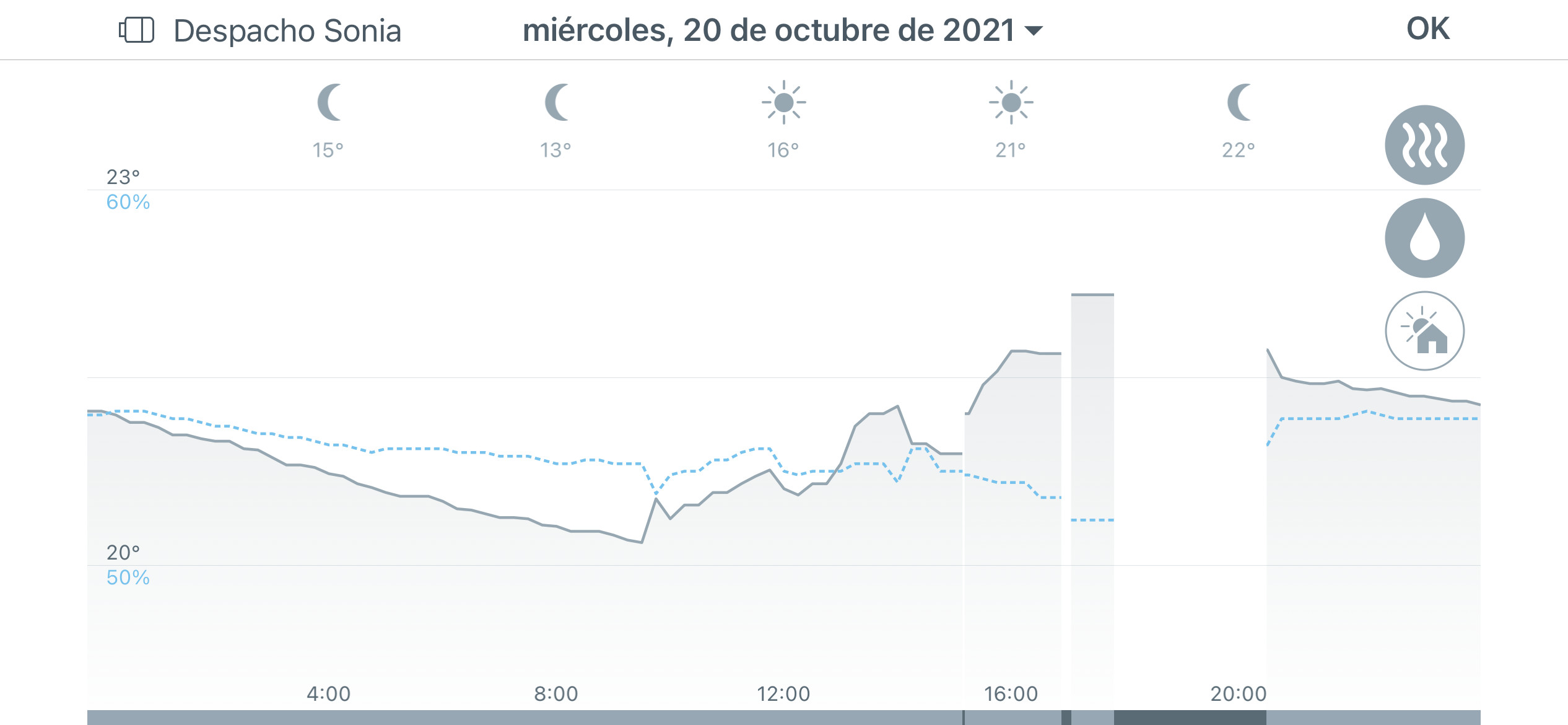

I have the Tado Smart Thermostat which controls the boiler based on the living room temperature (and family presence, weather forecast, etc.) and one Tado Smart Radiator Thermostat for a specific room where I want to control temperature more precisely.
It works great although, as it has been said, range can be an issue sometimes. The Smart Radiator Thermostat loses connection very frequently, but regains it automatically, like in this example (a very bad day, most days disconnections only last a few mins)
