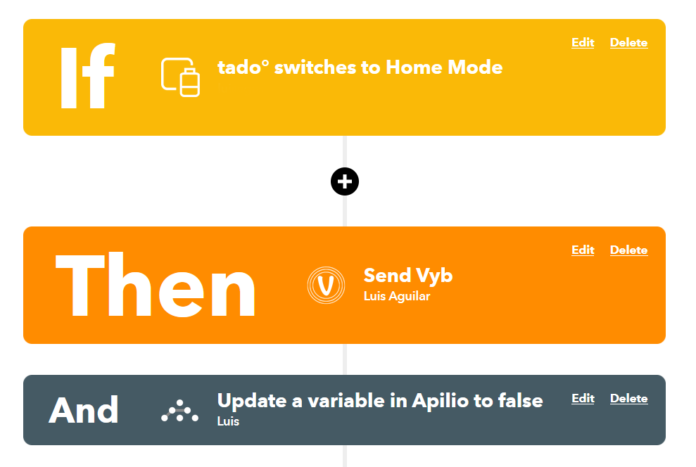

Create two IFTTT applets, one triggered when you go into each mode, and in the THEN definitions set an Apilio Boolean variable “away_mode” to TRUE or FALSE. You can then define a condition in Apilio to test the status of this variable, and act accordingly.

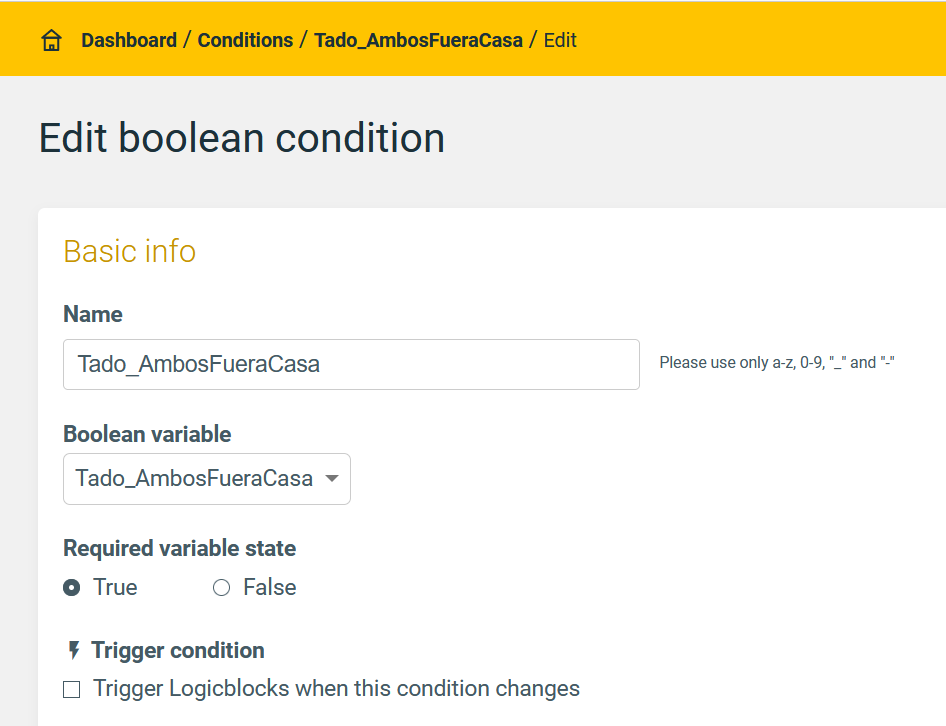

Now you can use those 2 conditions in your logicblocks easily to execute Apilio or IFTTT actions.
The ‘Tado_AwayMode_trigger’ condition lets you trigger a logicblock whenever Tado switches Home/Away (e.g. turn off all lights when Tado_AwayMode_trigger goes FALSE), while the Tado_AwayMode conditionn lets you control logicblocks based on presence (e.g. I only get motion notification in my mobile if Tado_AwayMode is True)

Have a look at what @teknofilo and I wrote. As suggested by each of us, the triggers are only used to set the status of Apilio variables. You then can read these at any time, not just when the status changes, and can act on them as required.
I already explained that. Update a boolean variable in Apilio whenever Tado switches via IFTTT. That variable will obviously keep its value until next change. Check that boolean variable via a condition whenever you need to execute an action based on Tado being away or home.
